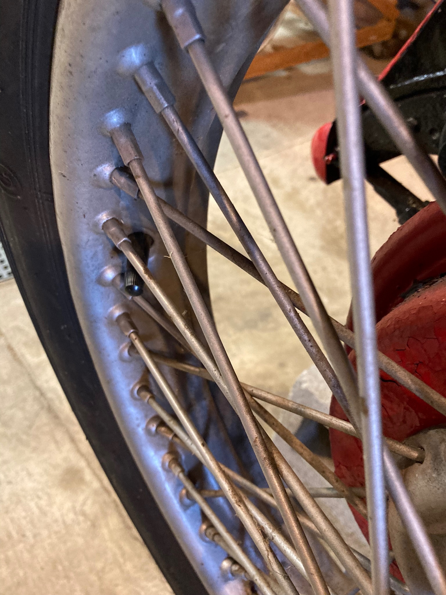

Looking again, I missed the obvious.
The car has MG TC wheels.
The TA wheels are sidelaced, the TC wheels are center laced.
Picture of TA spoke location attached.

Re: Thinking of adding this to my stable
Post by Steve Simmons » Mon Jun 19, 2023 7:27 am
The center lace wheels are correct for this TA. The change from side lace to center lace took place about a 25 cars before this one rolled off the line!
I'm not an expert on TA minutia but it looks really nice. Correct wings and tank for late TA. I agree the driving lamp is aftermarket, although still appropriate. Carpet is not original, steering wheel is aftermarket, and I'm not sure about the interior trim panels. The TC engine comes with a TC charging system (with TA control box) which changes a few things. From a practicality standpoint, this isn't a bad thing. The XPAG is obviously a far superior engine, and the 2-pole generator is far more simple to deal with. A lot of little details seem to be correct, like the valve cover nuts. The side cover is a rare Arnolt. Extra gauge in the dash (H2O which is a good idea IMO). Lots of little oddities like the giant wiper power wire but I don't see anything major wrong with it. I don't recall external trafficators so I assume those are add-ons.
