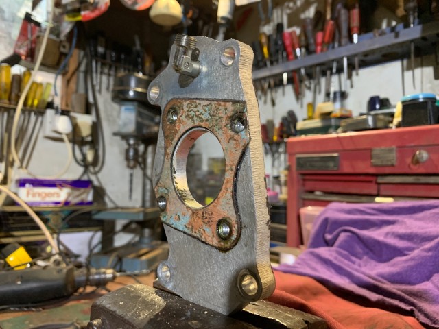

I have removed the supercharger end plate, tapped a 1/8" BSP hole and attached an adapter.
Hopefully this will work O.K. (If not I have a 45 amp output Dynamator/alternator.)

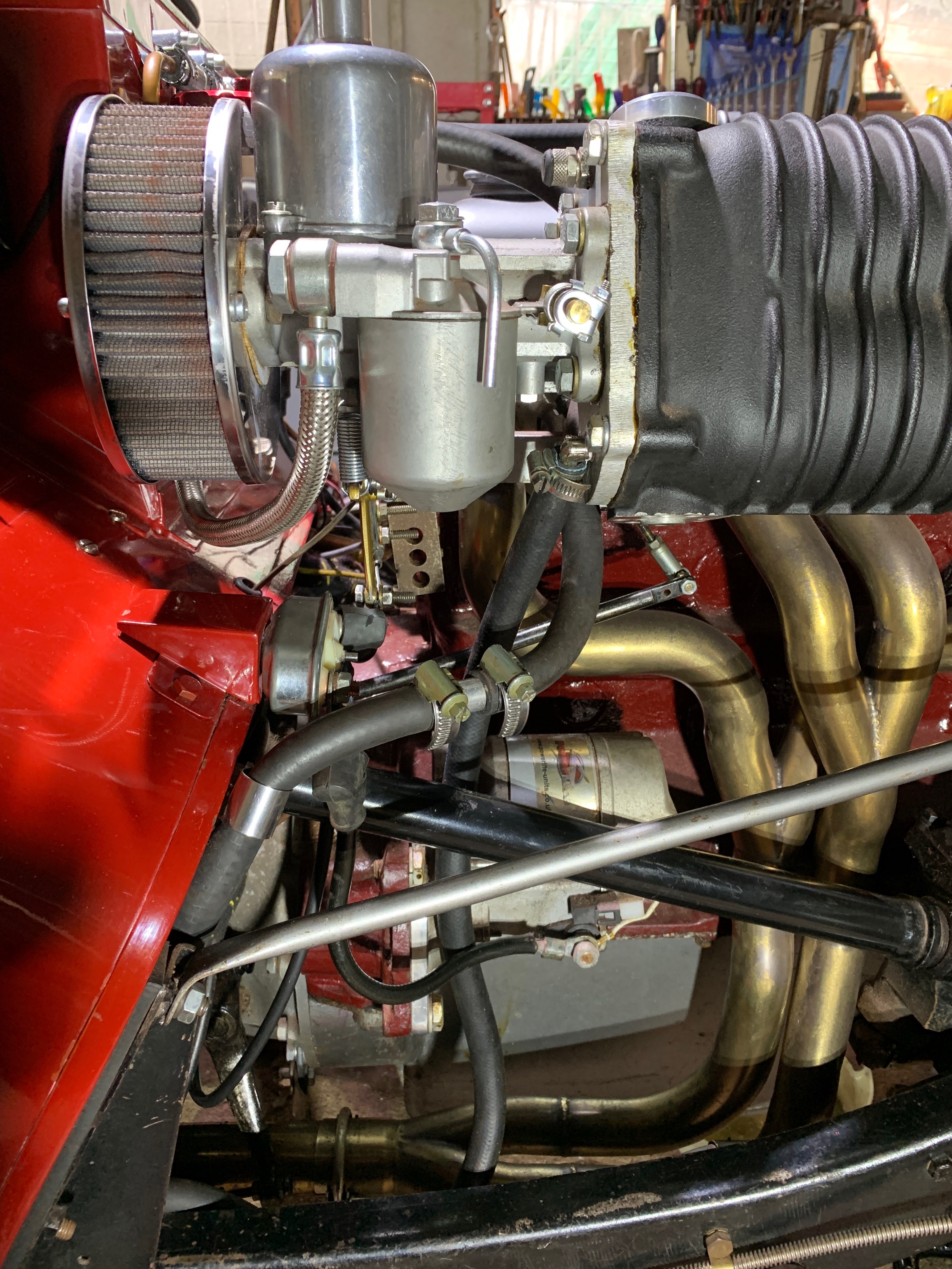

Post by Ray White » Wed Jul 17, 2024 9:51 am
I have taken the vacuum hose from the supercharger end plate. This apparently works but only time will tell
