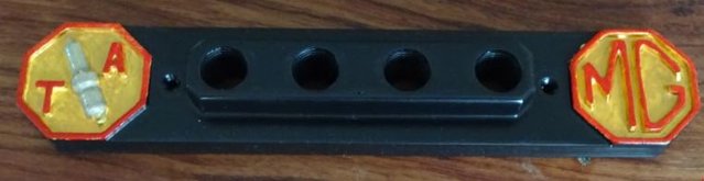

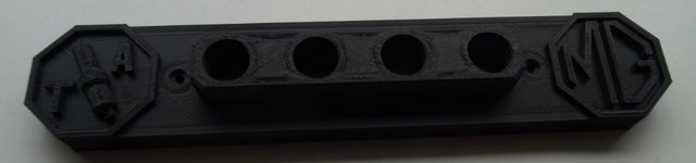

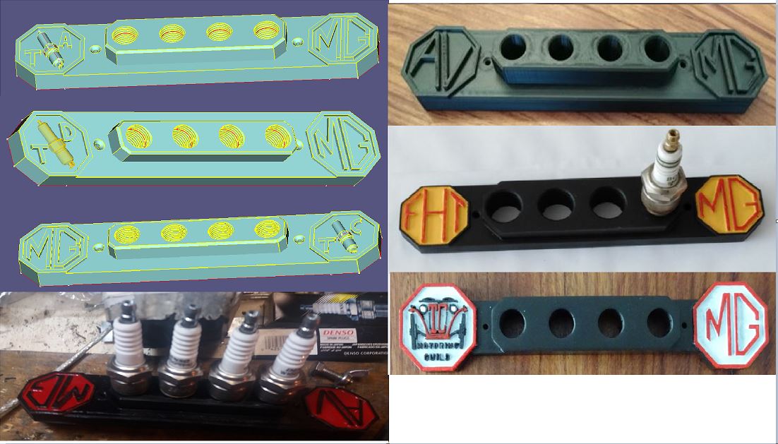

the
TA Spark plug holder
ABS special
with correct thread size
just from the printer

Hi Franz,
Is your intention to start selling these, or are you prepared to release the 3d printer file for free? The reason for asking is that I have a friend with a 3d printer who could run one off for me if he had the file. If you do intend to sell them, what would the price be (before and after Brexit ;) )
Steve
User avatar
Franz Tenbrock
Posts: 570
Joined: Wed Jul 11, 2018 9:39 am
Location: Waltrop Germany
Re: MG TA1932 in Germany - Tacho, Speedo, Steering, Oil Pres
Post by Franz Tenbrock » Tue May 21, 2019 9:17 am

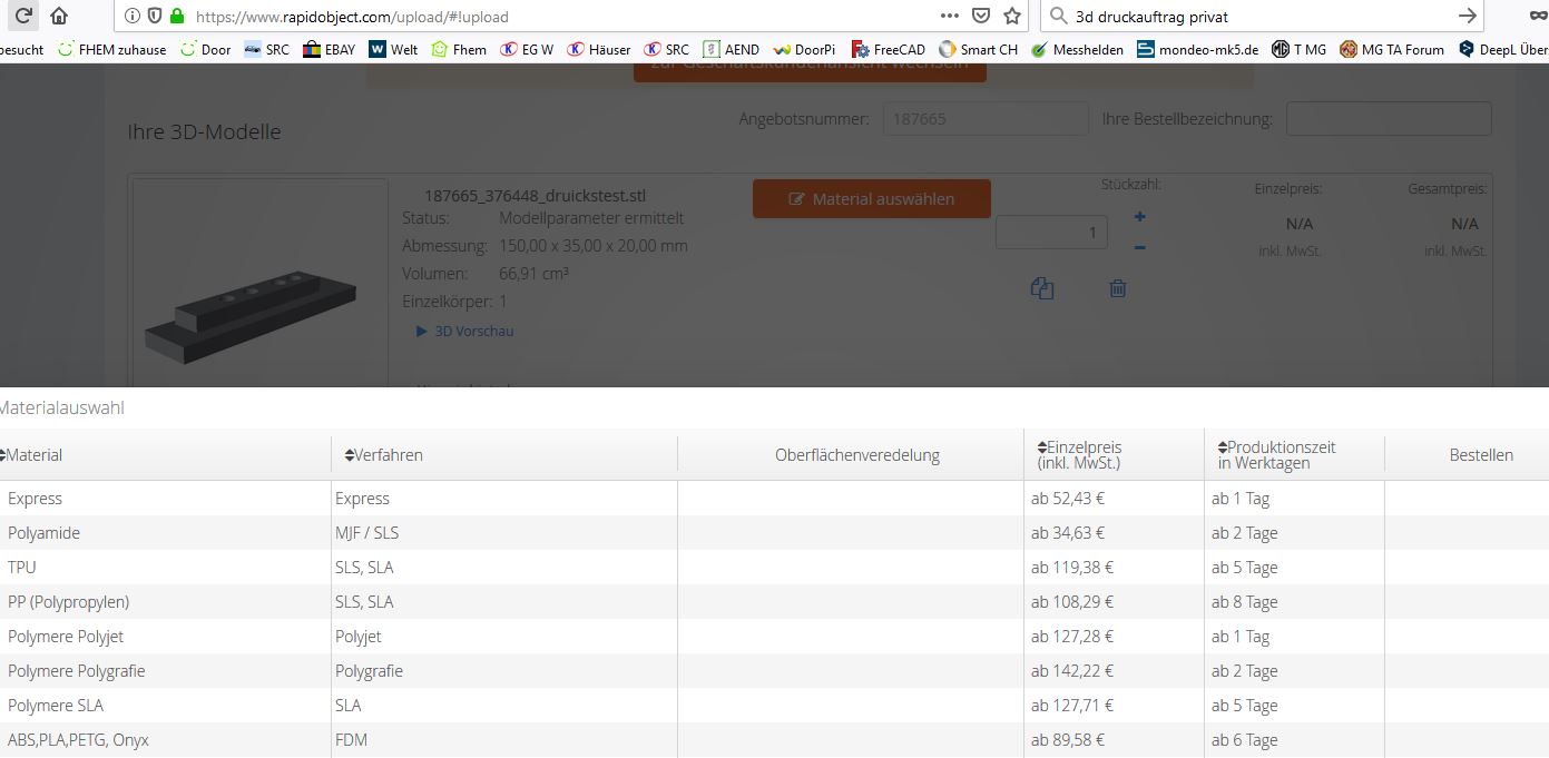

i will sell it printed but not painted.
it was some hours work, a lot of testprints also
i will make a really good price for it,
i want to use my printer to learn and become better ;-)
if you go to a printer job and print it with normal ABS you pay about 90 Euros for one !
i have done several individual Logos for other people here, so it depends what you want to have
standard will be the plug and TA TC TD TF ob the left side
individual with the letters of the name or something else.
i have upload an similar part to a printer shop. the price you can see in the picture. i print with titan X so you should not get problems with the heat under the bonnet
no warranty but you get one more than you order !

Post by Franz Tenbrock » Thu May 23, 2019 8:56 am
now painted in gold red and silver
its difficult to make a god picture
so if somebody wants one painted for TA - D
nor problem
ask me
It's totally relaxing to paint the parts.

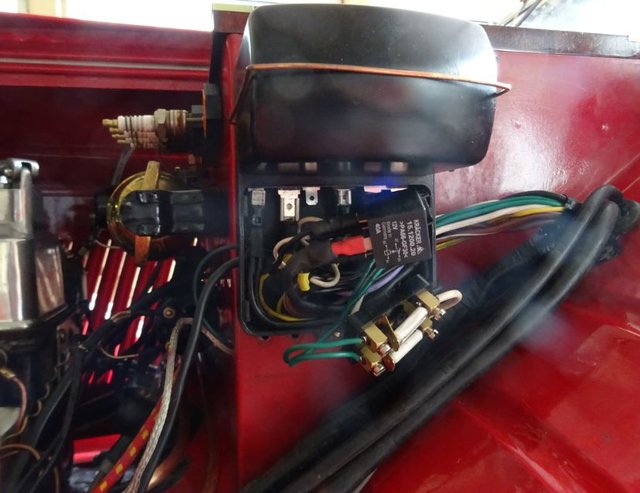

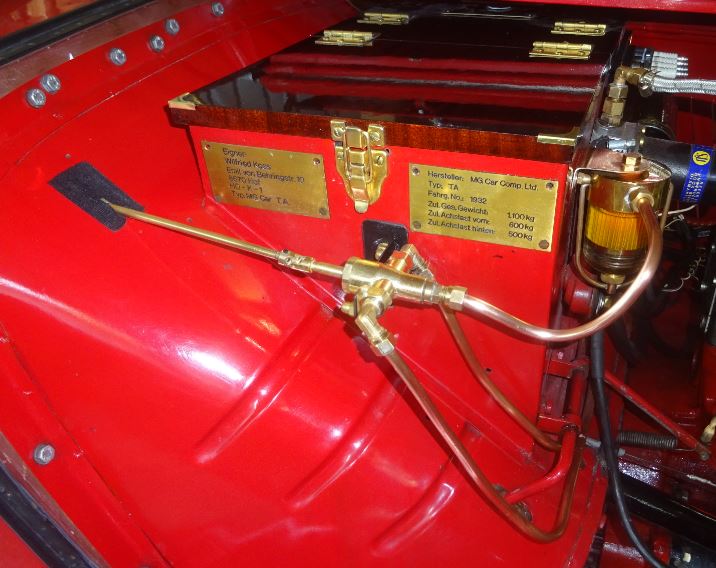

so next step
the crj3 like case i printed some month ago
is now at the place it should be
first i wanted to do it next winter, but it was raining today, so some time
tomorrow i have to make some new screws to fix the fuse case and fix the relay and the fuse,
perhaps i take a relay with fuse in it ??
so if i open the bonnet now
it looks orginal like and not so horrible as before 8) :P
so now two parts i can print for you
cjr3 like case for Lucas 340b
spark plug holder with individual design
original like case for a replica tacho or speedo

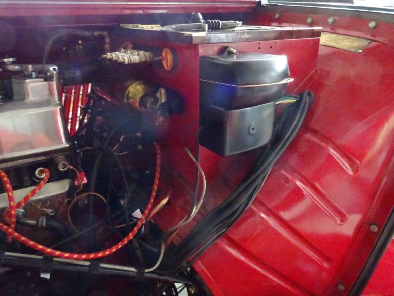

Post by Franz Tenbrock » Fri May 24, 2019 11:48 pm
so last work done
lock for the cover, stainless steel from the bay, plated with goldflash
fixed the wires
fixed the case with all screws
car is running :bow:
happy :P
the hole under the lock i will fixe a label
positiv ground car

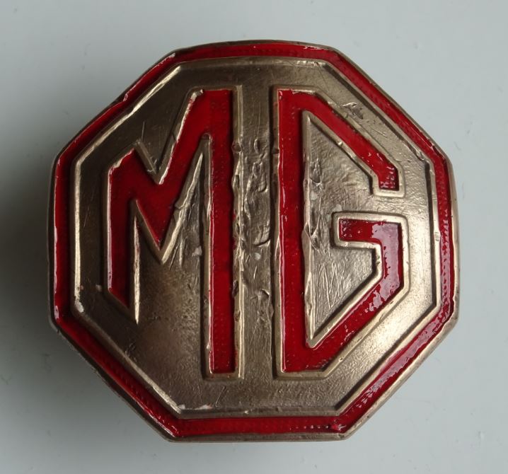

after i came home i go to my garage,

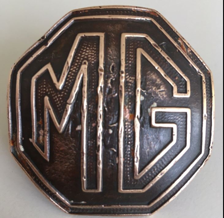

there i found a old MG Logo i bought some month ago
i take 1000 er wet paper to clean it,
after this i work galvanic first with paladium after this with goldflash
painted with red as my car.
my mg logo for wheel No 5 at the back i not so fine,
so this old new one will take the place

here a few pictures of my printed spark plug holders
to see what is possible.
you have a idea, i can try it
The holder from the Motoring Guild is only for the members of this club ! difficult to paint because so small

Post by Franz Tenbrock » Wed Jun 12, 2019 12:27 pm
car is running again,
it seems so
https://www.mgexp.com/forum/t-series-an ... n.3956834/
what have I done
I checked the gasoline filter and the pump.
I cleaned and oiled the air filter.
I have switched a direct line from the battery to the coil via a relay
i filled up the dumpers
i will drive the car some days, than i will fix the relay and the switch
in the winter i will change the electric behind the dashboard

Post by Franz Tenbrock » Sat Jun 15, 2019 8:33 am
Today I improved the fuel cock again and installed a cardan joint,
now it can be turned without problems.
Everything is gold-plated so that it doesn't oxidize and everything looks the same.
The wires from the relay also now new and at the right place
today sometimes rain, sometime sun
