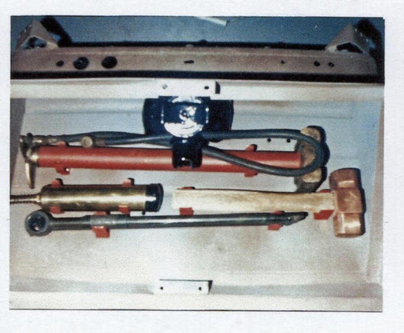

I haven't seen anything in literature about how the jack is secured in the car.  I am using a TC jack with longer handles - the handles don't fit well.  Also, what else goes under the rubber trays?  Any pictures?

Hello Allan,   Drawing of clips below trays attached.  The jack sits on a wedge-shaped piece of  wood in the centre of the tool box.  Info on tools is in the TA/TB Parts List.   Hope these help.
